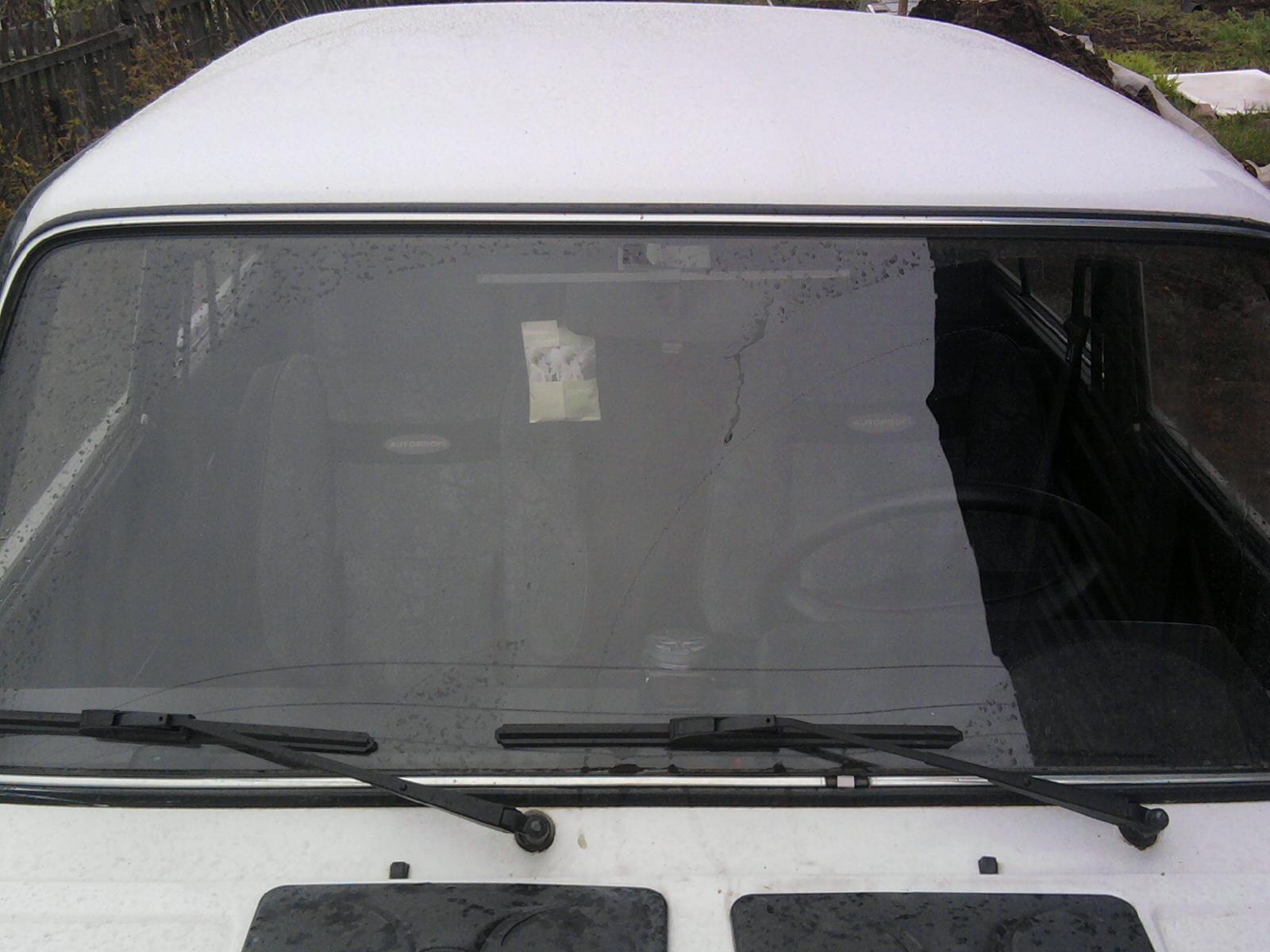

Новые дворники и поводки
EXIF-Data show/hide
Original image recording time:
2013:05:18 14:41:29
Image taken on:
Сб май 18, 2013 10:41:29
Camera-manufacturer:
Samsung Electronics
Camera-model:
U800
